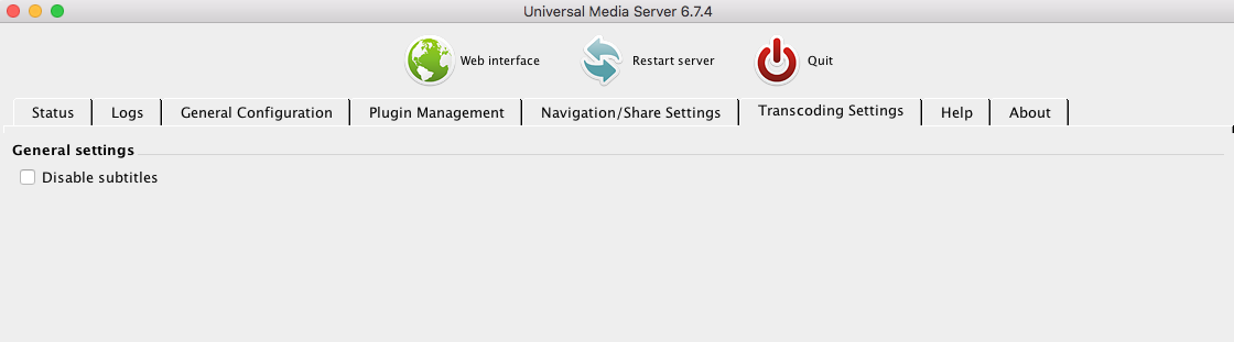

Adding to the problem my TRANSCODING SETTINGS window isn't displaying properly - only offers Disable subtitles by default each time.

Your GUI "problem" is because you've chosen to hide "advanced settings". Enable them on the "General" tab.

I have enabled 'advanced settings' as suggested and everything is now out on show in the Transcoding Settings window. Don't know how that happened other than if my earlier up-grade to UMS 6.8.0 somehow activated that setting when turned on for the first time. Anyhow - it's now working.

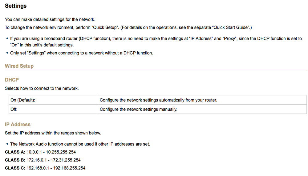

I have taken a look at the Marantz on-line manual and under settings it offers this:
MARANTZ NETWORK.png (94.95 KiB) Viewed 12373 times
It looks as if the Marantz is using CLASS C IP range.

Re: Mac High Sierra problems
When DHCP is enabled, it client (the Marantz) will use whatever IP address it is assigned. The ranges mentioned in the manual are the IEFT defined private IPv4 address ranges. All (that I've seen) NAT routers are configured to use one of these by default. If can can see on the Marantz that it is assigned 192.168.1.68 it indicates that the contact with your DHCP server (router) is working. Some devices will just keep the old address if they can't get a new one though, so it could only mean that they used to have contact. You should check in your router configuration, you can usually find a list of assigned (leased) addresses. In that list, make sure that 192.168.1.68 is "active" and not "released" or similar.
The IP range is correct and corresponds to the range/subnet used by your other devices. If the Marantz has network connectivity it's very strange that it doesn't contact UMS. My guess is that it doesn't currently have network connectivity, and that you won't find an active lease in the router.

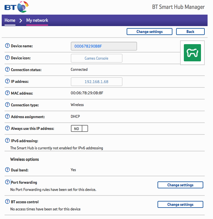

I have double-checked the BT Hub Network info and get this :-
BT SMART HUB.png (104.13 KiB) Viewed 12367 times
As far as I can understand it all seems to be 'connected' albeit identified as 'Games Console' - but all the IP addresses, etc seem to add up (I think?).
The MAC address is the same as shown on the Marantz unit.
This screen grab was taken after I left the Marantz disconnected from the mains for 1hour and then turned it all back on, etc.
Is there anything above that shouts out to you as being 'suspect'?
No, everything seems fine. I really have no idea what might cause this then. The way it works is that UMS announces it's existence on the network, and that interested parties then contact UMS. According to your log file the Marantz never contacts UMS, although a lot of other devices do. That makes it very difficult to know why as long as the network connectivity is working.
Since the other devices seems to be able to connect to UMS, it doesn't seem like you have a firewall problem blocking the Marantz either. You could always try to disable the firewall running on the mac to be sure, but it seems unlikely. The only other thing I can think of is that your router has some internal issues. If you haven't, you should try to power-cycle the router as well.
