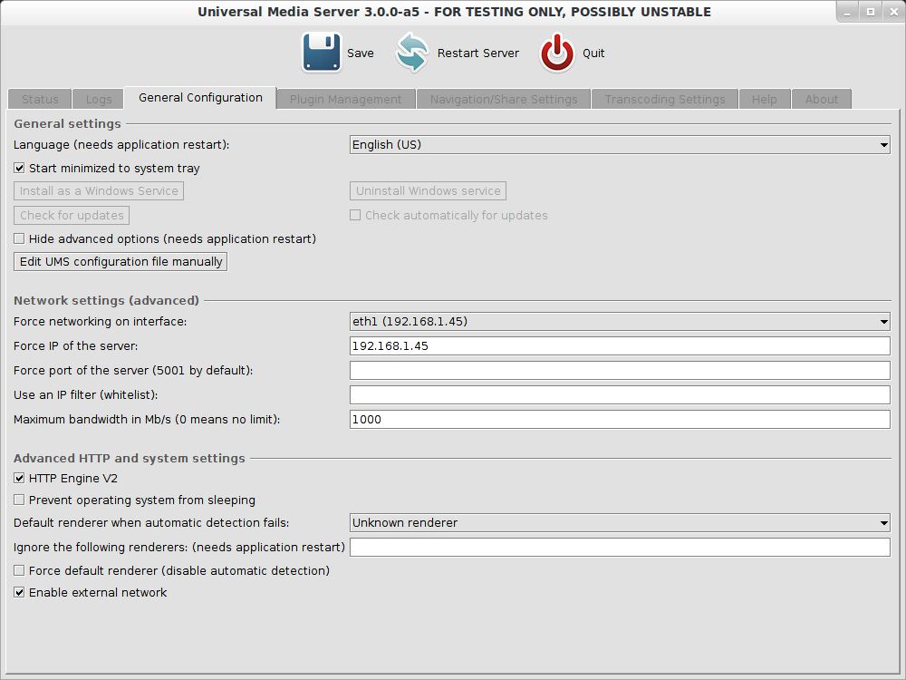

I also tried forcing the server IP as seen in the included screenshot. This was suggested to someone on the PMS forum, but it didn't help me either.

- IP settings in UMS
- UMS.jpeg (303.05 KiB) Viewed 14157 times
