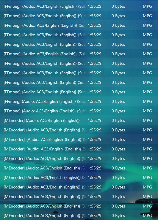

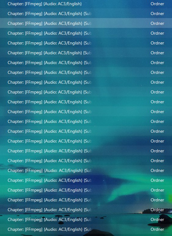

Hi!
I'm a new user to UMS and I'm quite impressed about the efforts you've spent for making such a great streaming server.
I was wondering if it is possible to limit / select the options shown in the transcoding folders since the list grows quite long (at least for me).
For every possible configuration there's an item:
- Chapter
- Video encoder
- Audio encoder
- Language
- Subtitles
- No transcoding
For the encoding, language, subtitles it would be good enough to use standard settings for me (such as only ffmpeg, original audio, preferred languages or English only).
Otherwise the list is so long... )-: Attached you can see a small part of the list.

You can turn of chapters in the configuration, and I actually think it's off by default.
You're not supposed to use the TRANSCODE folder normally, if your renderer, audio and subtitles preferences are configured correctly, UMS should pick the correct "variant" outside of the TRANSCODE folder. The TRANSCODE folder is only for those few instances where the automatic selection doesn't get it right or for testing.
