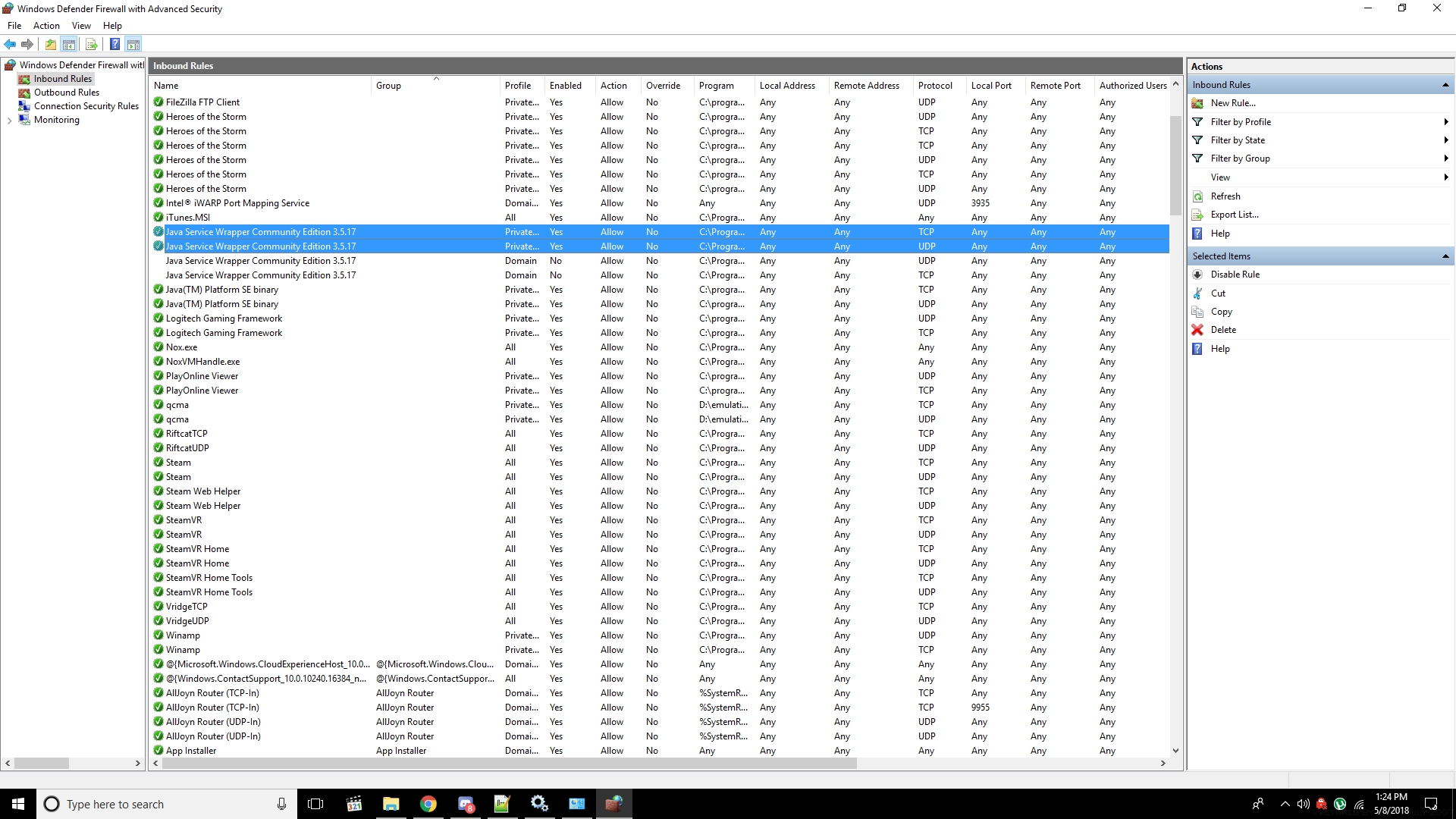

As you can see from the provided image, the firewall has settings for TCP and UDP for ALL PORTS allowed for wrapper.exe
- firewall.jpg (701.65 KiB) Viewed 7902 times
Re: Roku cannot see Window 10 Service
Yes, but as I said in the previous post I discovered that Windows assigns permissions to services not by the EXE file but by the service itself. If you double-click on any of these rules and then selects the "Apps and services" tab and click the "Services" button you can assign the rules to the "Universal Media Server" service instead of to the EXE file. Do this for both rules, and I guess it should work.
