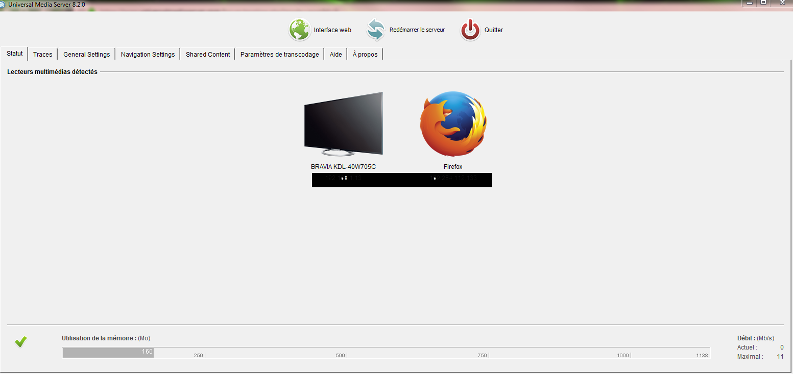

Question 1 :
I have a problem with UMS (last version on x64 and windows 7 pro). I see the TV detected on the status page of UMS , but the TV don't show the UMS server while the >TV is displayed as "on line".
I also tried to open a specific port and open this port on the box but nothing worked !
I can connect the TV with "Servio" without any problem
Do you have an idea to help me use UMS ? Servio is not what i want because of the lack of options and configurations.
Question 2 :
I'm unable to connect my android smartphoine (7.1.1) to UMS ( i didn't found anything on google about configuring VLC or a specific file explorer to be able top connect to UMS ).
Some help would be appreciated (or a link to read) !
Have a nice evening, thanks

- status page
- Capture.PNG (114.24 KiB) Viewed 4163 times

Re: Sony KDL40w705C - UMS not detected
The UMS have choosen wrong network interface but it should use the because your TV has address
You have to set the correct network interface manually.
Using address /169.254.112.133 found on network interface: name:eth8 (VMware Virtual Ethernet Adapter for VMnet1)
wlan0, display name: Wireless AC600 Dual Band High-Gain USB Adapter
available addresses for wlan0 is: [/192.168.1.11]
BRAVIA KDL-40W705C, address=192.168.1.13
Thanks to you i can now use a real multimedia server, not Servio or others useless softs!
I'm really bad to didn't notice this interface mistake .... i really thanks you for your help !!
