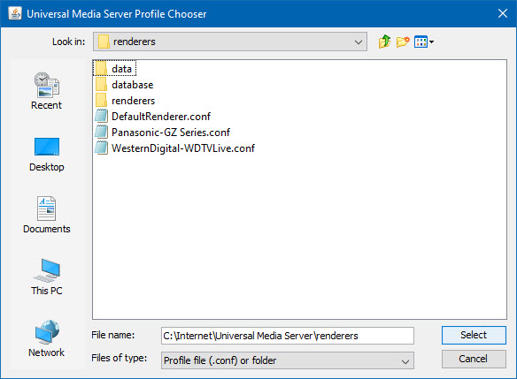

I tested your question regarding the correct profile being used:
Started UMS by using the (Select Profile) option. Select Panasonic GZ Series. The other profiles have been renamed to .xconf so don't get listed and shouldn't be used. So I do not for the life of me know why it is selecting an invalid conf file! I think for now I need instruction as to how to prevent UMS from using a file that does not exist!

Re: Constantly Reading But Nothing Displayed
You have mixed up "profile" and "renderer configuration". Both are .conf files, but they have different content. "Profile" means the whole configuration, and you should just forget about starting with "select profile" (that's for advanced use when running several UMS instances with different configuration at once). You should just use the default profile, which is UMS.conf found if in "%ALLUSERSPROFILE%\UMS".
Renderer configurations are different, and should be put in the "renderers" folder in UMS' installation folder ("C:\Program Files...").
UMS can only have one "profile" or "main configuration file", but it can have many renderer configuration files.

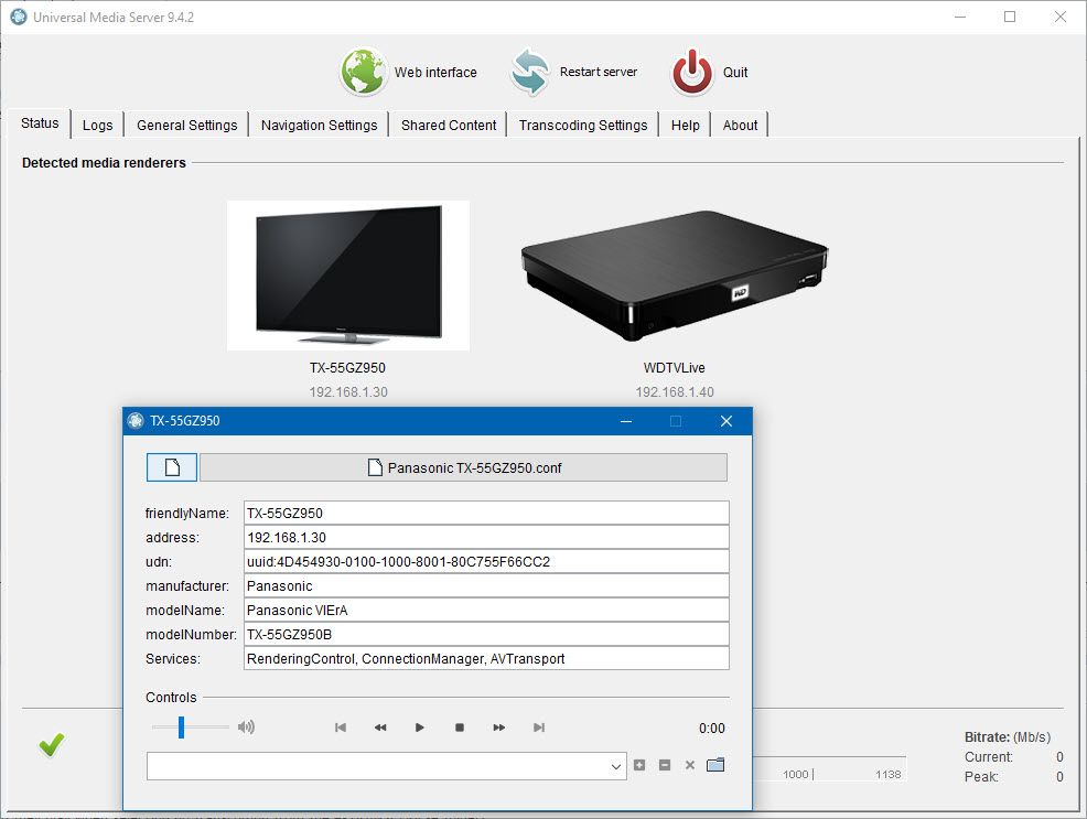

I think you have misunderstood what profiles and renderer configs are and you have ended up down a rabbit hole that is hard for us to help you out of, and you have not given the logs that would have let us help.
There are some things from your screenshots I noticed:
The install directory is not what it should be, it is "C:\internet\Universal Media Server\" when it is usually "C:\Program Files (x86)\Universal Media Server\"
you have used the "customise this device" when clicking on the renderer icon, this creates a new config that overides any existing config for that device only, and that file is stored in the "%ALLUSERSPROFILE%\UMS" directory. eg from my tv
New renderer configs should be copied to the "C:\Program Files (x86)\Universal Media Server\renderers" directory for them to be seen by UMS. If it is possible for more than one config to match when detecting your renderer then the first will be used unless a higher priority has been given.
Forget about profiles and running multiple instances/as a service. That is for advanced users who may want to separate servers e.g. private and public and with different profiles they can run together without conflict. running more than one with the same profile causes problems.

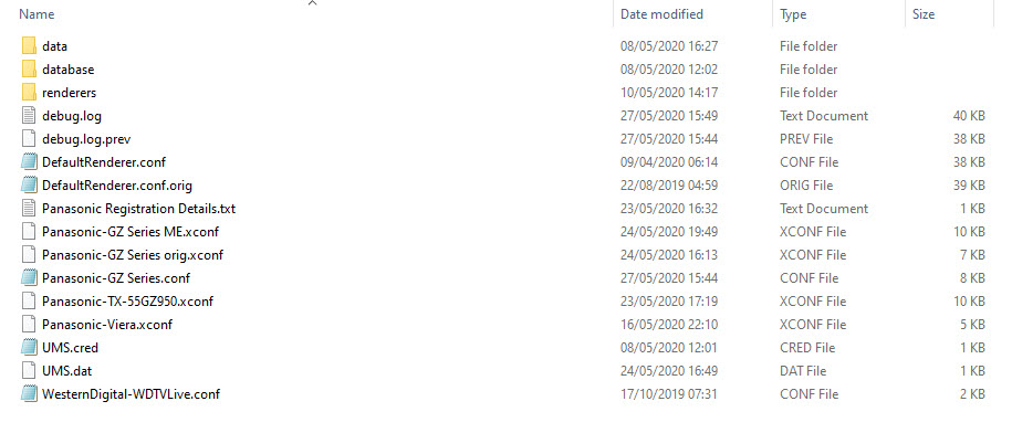

# Options in this file override the default settings for the specific [TV]Mik's TV device(s) listed below.
# Specify devices by uuid (or address if no uuid), separated by commas if more than one.
Device = uuid:0c845881-00d2-1000-9438-f47b5ebe1def
It would be best to fully uninstall UMS, goto the "%ALLUSERSPROFILE%\UMS" directory and delete everything and reinstall from scratch using default location and options, selecting "clean install" to make sure.
Copy the config I made to "C:\Program Files (x86)\Universal Media Server\renderers"
Only set the shared folders and don't touch anything else
Test on your TV to see if UMS shows up and see if files play then post logs so we can figure out any other issues.
We are trying out best but calling us morons for your misunderstanding is not helping. Nobody else has had the issues that you are having.
