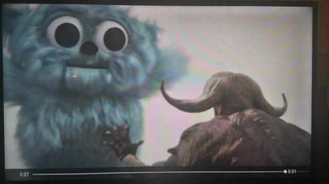

I think that is how transcoded streams are being played on those devices. My Samsung TV shows the total time of a transcoded file to be 0:04, but the current play time goes up normally. It also disables the seek controls.Nadahar wrote: ↑Sun Jun 28, 2020 6:41 pm DLNA actually has a "mode" where the server controls playback, and the renderer just consumes the stream. For those renderers that supports this, it would be possible to feed it whatever one wanted, and the renderer would only serve as a "stupid slave" which didn't try to make sense of time codes etc.
On Movian the length is shown as 0:01, but the progress bar extends past that off the screen when playing. Annoyingly it dosn't disable seek controles so if you forget it's transcoded and hit rewind to go back a few seconds, it goes back to the start.
