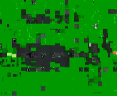

So recently I've been experienced like green pixalation/tear in the black levels of movies when I play with FFmpeg, AviSynth/FFmpeg, MEncoder, AviSynth/MEncoder, tsmuxer, No transcoding and the normal videofile that exist before I even enter the transcode folder. I'm usually playing 1080p files with .mkv h264 on a Toshiba TV through DLNA which always worked before. I have tried different containers like .mkv, .mp4 .webm, different resolutions and video files. Every transcode option seems to make the dark parts of the video go crazy and the brightness go over bright and the whole monitor starts to flicker. Here's a quick example image of how it kinda looks like.
Except if I play the movie with the last VLC transcode engine it works fine and everything works as it should although it's a bit blocky/pixalted for some reason, but 100% watchable. If I played a movie with lets say FFmpeg and the screen goes bright/flicker it stays stuck on the monitor even when I exit the movie back into the folder in the TV menu, then if I start to play it with VLC transcode it "repairs" the screen an brings it back to normal.

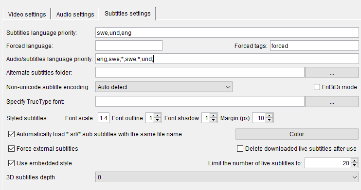

However the other codecs on my TV keeps look broken, only VLC engine that's works okay but it seems to default english subs even tho I have set my native language as first in "Sub priority settings", "Forced Language" and "Audio/sub language priority". The english sub is even 2nd on the list when I open the file normally in VLC on PC, but when I UMS with VLC engine to my TV the english auto loads and my other language is presented on top of that (please note that with ffmpeg, mencoder it displays only my native language sub like I want but it's unwatchable due to the other issue).

Arc ッ wrote: Wed Aug 05, 2020 7:18 am However the other codecs on my TV keeps look broken, only VLC engine that's works okay but it seems to default english subs even tho I have set my native language as first in "Sub priority settings", "Forced Language" and "Audio/sub language priority". The english sub is even 2nd on the list when I open the file normally in VLC on PC, but when I UMS with VLC engine to my TV the english auto loads and my other language is presented on top of that (please note that with ffmpeg, mencoder it displays only my native language sub like I want but it's unwatchable due to the other issue).
I took a screenshot of my settings if it helps, any suggestions would be very appreciated because having double subtitles at once is. 🥴
