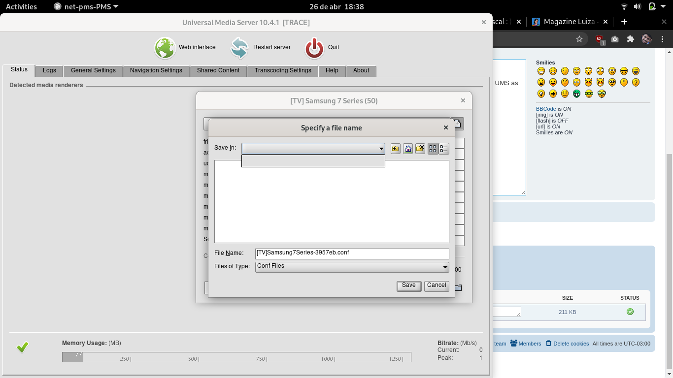

I've been trying to watch a movie (mediainfo at the end) on my TV (Model: Samsung RU7100).
File just doesn't play, I can access UMS fine and there's also a different file that works. I know that the problem is with the TV because if I try to watch from VLC, using UMS as source, it works.
Message on TV is: "unexpected error" and/or "file not supported".
I bet that I should change my "Samsung_UHD.conf" but I can't (screenshot attached). When I try to change this conf, there's an empty File Picker dialog that I can't move (bug?).
My distro is Arch Linux and I've installed UMS through AUR.
Thank you for any support, it's much appreciated :D
Screenshot from 2021-04-26 18-38-57.png (103.52 KiB) Viewed 7904 times

Looks like UMS is trying to transcode that file as it thinks your TV does not support the codec used. That file uses
Codec ID                                 : dvhe
Codec ID/Info                            : High Efficiency Video Coding with Dolby Vision
which is one I have not seen before. (maybe something to do with HDR :?: )
It is a good chance that the conf file is correct that that format isn't supported by your TV but to confirm, try playing it from the #--TRANSCODE--# folder by selecting "No Transcoding". If the file plays correctly then the conf can be tweaked.
The reason that transcoding is failing is probably down to the size of the file, network speed and CPU power. It takes a powerful computer to transcode 4k it in real-time, not sure a 2 core i5 is up to that task.
You could try to re-encode that file yourself with something like HandBreak, or try to find another copy that should be more compatible.

Well, I've tried to run every file inside " #--TRANSCODE--#" folder and none worked. But I think that's probably because of server machine, as you noticed is an old notebook.
I say that because, I've run UMS with sudo so I could change my "Samsung_UHD.conf" and it worked. I got this one: viewtopic.php?t=13270
I've tried to copy a small video using same format just to local test the TV and it also worked, so I guess it has native support.
As this was solved changing configuration do you know a proper way for me to change (UMS) TV conf file without using sudo?
