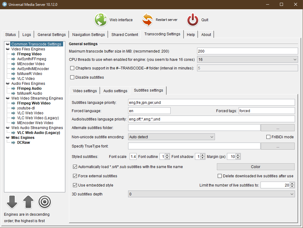

I can't find the subtitle language priority setting. This is what I'm seeing in my subtitle options, with these settings there are no subs on the ps4. Can I burn them in or something? See attached image.mik_s wrote: ↑Thu Sep 23, 2021 4:23 pm You should be able to turn on subtitles on your PS4 if the video you are playing is supported and is being streamed.

You can enable subtitles in the PS4 by pressing the options button and selecting the (...) icon and you can pick the subtitles to use. If transcoding this will not show anything as the subtitle will have to be burned in to the video.
It is possible to stream external subs separately instead of burning in but does not work for internal subs. TBH I'm not sure that works any more but I have that option enabled for my PS4.
It would be great if all subs (including internal) could be added to the stream but I think it is limited to just the 1
Your language priority is eng,off;und,off;*,eng;*,und which basically means
But if you just want then on every now and again it is best to play from the #--TRANSCODE--# folder
- if audio is eng then turn subs off;
- If audio is undefined then turn subs off;
- If audio is anything else use eng subs;
- If audio is anything and there is no eng subs use undefined subs (subs that have no language defined)

ahh ok I get it now. Everything is working fine, thank you.mik_s wrote: ↑Fri Sep 24, 2021 10:01 am You can enable subtitles in the PS4 by pressing the options button and selecting the (...) icon and you can pick the subtitles to use. If transcoding this will not show anything as the subtitle will have to be burned in to the video.
