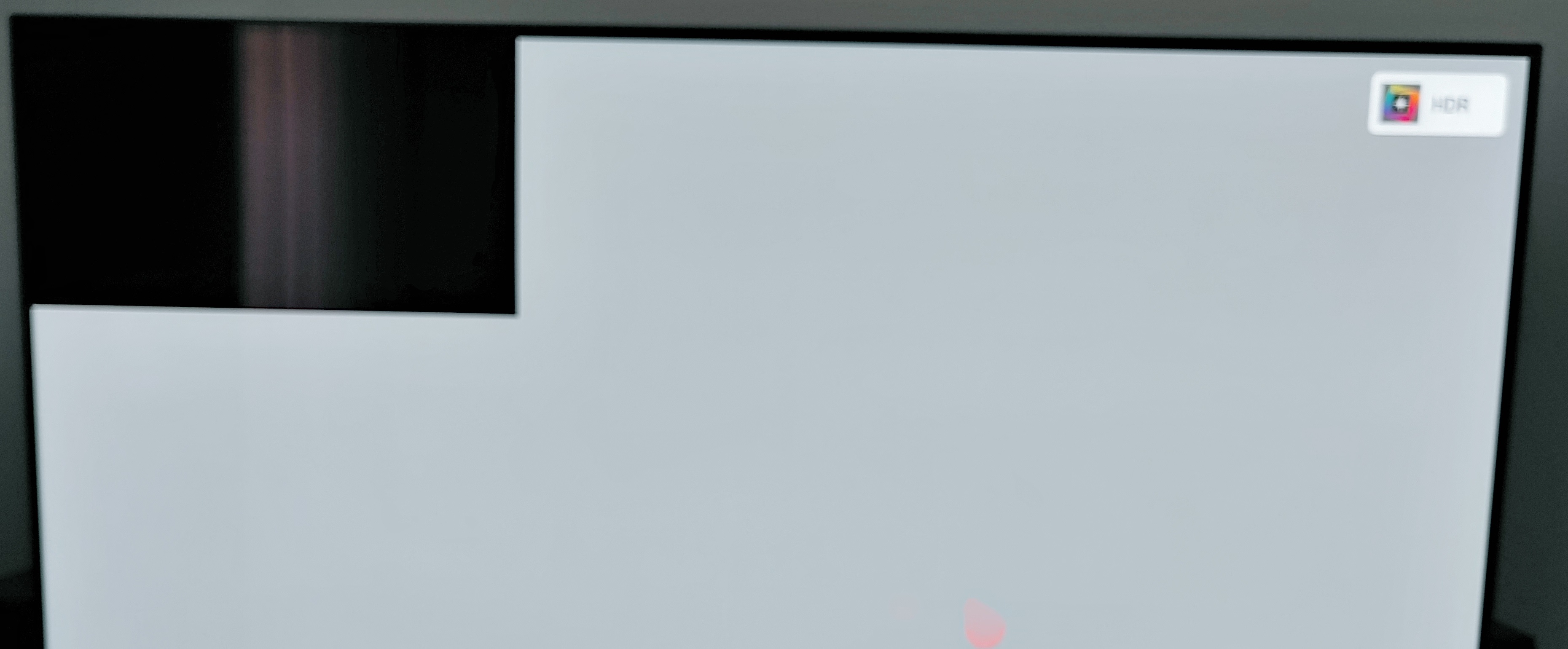

I have tried file which MediaInfo reports as:
HDR format: Dolby Vision, Version 1.0, Profile 8.1, dvhe.08.06, BL+RPU, no metadata compression, HDR10 compatible / SMPTE ST 2086, Version HDR10, HDR10 compatible
When I have used clean 2020+ config file I got this for 2 seconds:
After that the file play as usual. After modifing 2020+ config with adding dolbyvision in hdr for mkv files I got just HDR pop up.
