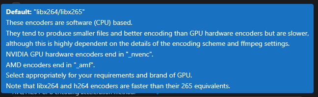

Did you set it the GPU encoding acceleration method?
Screenshot 2025-03-04 163538.png (49.13 KiB) Viewed 6621 times
Screenshot 2025-03-04 171257.png (20.3 KiB) Viewed 6621 times

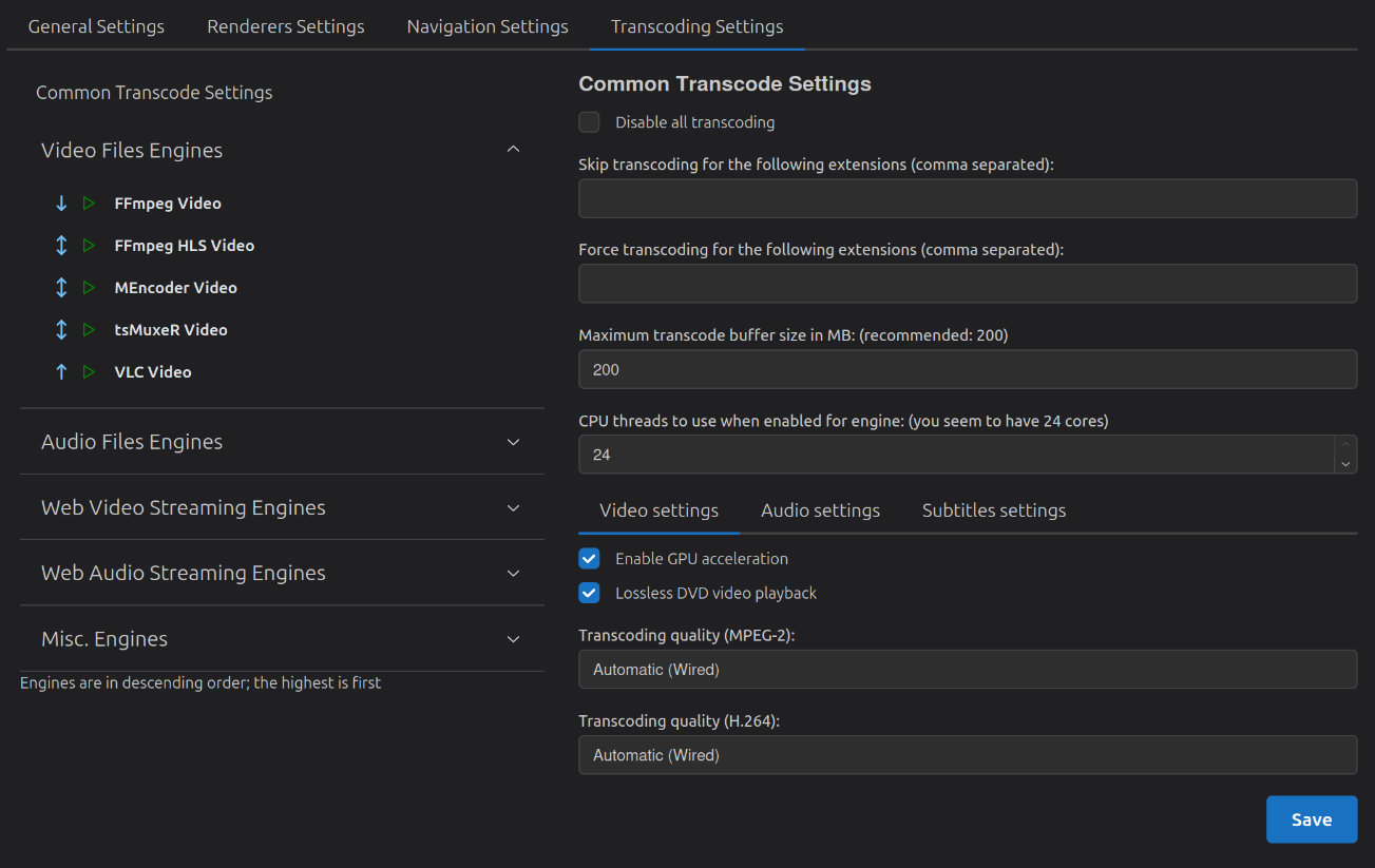

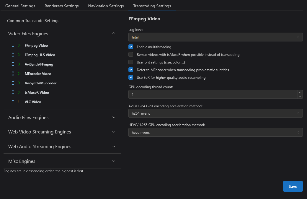

mik_s wrote: Sat Mar 15, 2025 11:31 am Did you set it the GPU encoding acceleration method?
I believe I have set this correctly? Refer to below attachments:
Common settings
Common settings
Screenshot From 2025-03-17 00-12-44.png (162.13 KiB) Viewed 6568 times
ffmpeg settings
ffmpeg settings
Screenshot From 2025-03-17 00-13-47.png (136.86 KiB) Viewed 6568 times

Unfortunately, still unable to play - error code 234, also the negative duration, which makes me wonder if it is somehow involved in this issue? Looking at your comment, it seem the calculation just needs brackets...
INFO  22:03:20.326 [StartPlaying Event] Started playing bbb_sunflower_2160p_30fps_stereo_abl.mp4 (FFmpeg Video) on your BubbleUPnP
INFO  22:03:21.291 [ffmpeg-3] Process /usr/bin/ffmpeg has a return code of 234! Maybe an error occurred... check the log file
INFO  22:03:22.328 [Thread-71] Exception in thread "Thread-71" java.lang.IllegalArgumentException: durationMillis must not be negative
INFO  22:03:22.328 [Thread-71] 	at org.apache.commons.lang3.Validate.inclusiveBetween(Validate.java:337)
INFO  22:03:22.328 [Thread-71] 	at org.apache.commons.lang3.time.DurationFormatUtils.formatDuration(DurationFormatUtils.java:358)
INFO  22:03:22.328 [Thread-71] 	at org.apache.commons.lang3.time.DurationFormatUtils.formatDuration(DurationFormatUtils.java:341)
INFO  22:03:22.328 [Thread-71] 	at net.pms.renderers.devices.players.PlayerState.setPosition(PlayerState.java:100)
INFO  22:03:22.328 [Thread-71] 	at net.pms.renderers.devices.players.PlaybackTimer.lambda$start$0(PlaybackTimer.java:54)
INFO  22:03:22.328 [Thread-71] 	at java.base/java.lang.Thread.run(Unknown Source)
INFO  22:03:27.019 [ffmpeg-5] Process /usr/bin/ffmpeg has a return code of 234! Maybe an error occurred... check the log file
INFO  22:03:35.646 [ffmpeg-7] Process /usr/bin/ffmpeg has a return code of 234! Maybe an error occurred... check the log file
INFO  22:03:41.295 [ffmpeg-9] Process /usr/bin/ffmpeg has a return code of 234! Maybe an error occurred... check the log file

Web player works, but seems to be using the ffmpeg HLS transcoding, so is using software transcoding on the CPU (FFMPEG HLS Video is reported in the logs, and consumes about 450% CPU during the process with 0% GPU), rendering via Firefox on Android (which is detected properly in UMS also).
I can also confirm, disabling transcoding works in this particular case (I have the codec pack installed and my test phone (Galaxy S22 Ultra) seems to have a good level of HW native decoding support, so this probably helps!). I forgot to mention, weird resolution of the video is due to it being a 3D video. I'm not playing it like this though, I just want to see transcoding work properly for formats that aren't natively supported or on other devices with less capability.
I've attached another trace with the error 234.

Yes, I forgot to mention - I did try that, but it also didn't work - the below is the result:
ERROR 22:25:46.974 [jupnp-stream-server-106] No Hls configuration to transcode.
ERROR 22:25:52.974 [jupnp-stream-server-106] There is no inputstream to return for bbb_sunflower_2160p_30fps_stereo_abl [FFmpeg HLS Video]
Interestingly, I also tried a slightly older version of ffmpeg I compiled myself with all the nvidia headers included - and it also threw the error 234 (same as the OS version of ffmpeg) - it still makes me wonder if the hardware transcoding is somehow completely broken with this nvidia driver? It's a real headache to downgrade to an older version - but I did find a single commenter online who suggested HW acceleration might be broken driver >535 (I'm running 560 non-open driver). As I only found a single comment on that, I'm not so sure it is true however...
