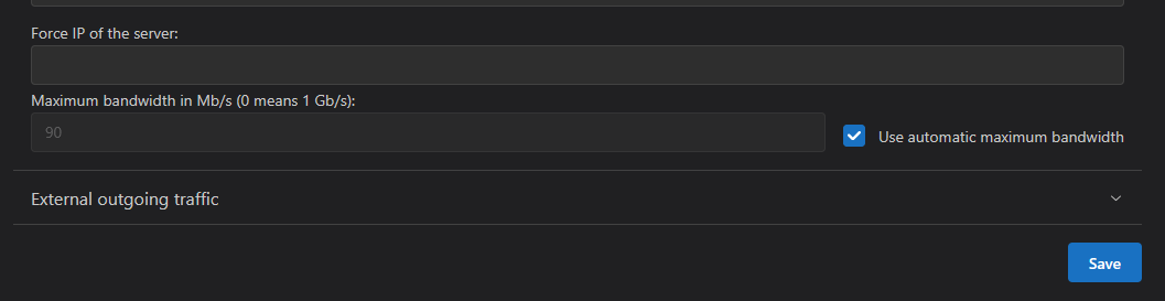

Also try turning on "Use automatic maximum bandwidth" so it will use the max allowed by your network bandwidth to the TV.

Set this back to the default 90 and turn on "Use automatic maximum bandwidth" so UMS will run a speed test to use the best value for your network to the TV.
Even if you have Gigabit ethernet your TVs LAN port will be limited to 100mb/s as it does not need anything faster and these are cheaper for the manufactures to use.

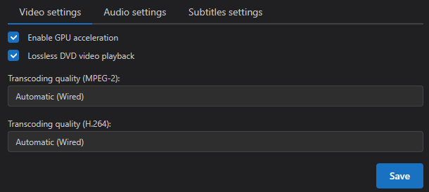

There are also a couple of other options that could be causing it to fail. Set "Transcoding quality (MPEG-2):" and "Transcoding quality (H.264):" to Automatic (Wired) You will have to change these before turning on use automatic maximum bandwidth as it disables this selector.
I'm not sure if it also ignores the settings here but best to do it anyway.

Re: ffmpeg does NOT understand "-maxrate 999000k"
My TV connects to wireless network at 780mbit/s, idk why devs found out that 30mbit would be the wireless ideal, maybe they're still in 2010?
Anyway changing max bitrates wouldn't fix that command line. It will still try to limit hardware encoders' bandwidth with -maxrate and ffmpeg doesn't allow that. It's not me, nor my computer, nor my TV, it's UMS's built-in ffmpeg that's complaining.

I've changed all you mentioned and now it says:
"This file type cannot be played on this TV"
