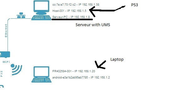

Re: No media servers were found
I forced the IP address to be sure, but I have only a network card.
I just reconfigured and generate news logs with my network schematic ...
PC and PS3 (or TV) are not connected directly. But through my BBOX.
- LAN.jpg (25.67 KiB) Viewed 12965 times
- (15.26 KiB) Downloaded 827 times
In your log I could see UMS starting normally:
INFO 2014-03-24 21:19:39.229 [main] Created socket: /192.168.1.8:5001
DEBUG 2014-03-24 21:19:39.348 [main] Sending ALIVE...
DEBUG 2014-03-24 21:19:39.389 [main] Reading uuid: default: null, current: "590dac68-11a4-4b7a-962c-7151223e008e"
INFO 2014-03-24 21:19:39.389 [main] Using the following UUID configured in UMS.conf: 590dac68-11a4-4b7a-962c-7151223e008e
INFO 2014-03-24 21:19:39.642 [main] The server is now available for renderers to find
But later on it seems to stop (and I don't know if you stopped it or that UMS stopped itself):
INFO 2014-03-24 21:20:57.561 [background-task-0-restart(0)] Stopping server on host 192.168.1.8 and port 5001...
And I don't know why it's doing that.
Are you sure that your PS3 is correctly connected to your network?
Because the log does not show 192.168.1.5 or 192.168.1.38. I would check that first.
You should be able to ping it from your laptop: ping 192.168.1.5 (or is it 192.168.1.38? Not very clear in your diagram).
Also if you have an Android device, you could try and install the app Fing.
Fing will show you all the devices on your network, as well as the services running on the device.
Your connection of the PS3 via the BBOX is wired or wireless?
Hope it helps...
hello,
yes, it is strange.
I ping my PS3 without problem. I play online game with...
it 192.168.1.38 is my TV, it doesn't work too.
I'am able to ping these device from my laptop or my server..
I will install Fing and try to find anything...
yes, it is strange.
