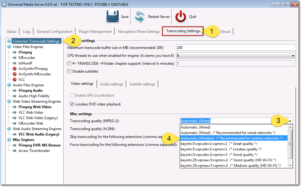

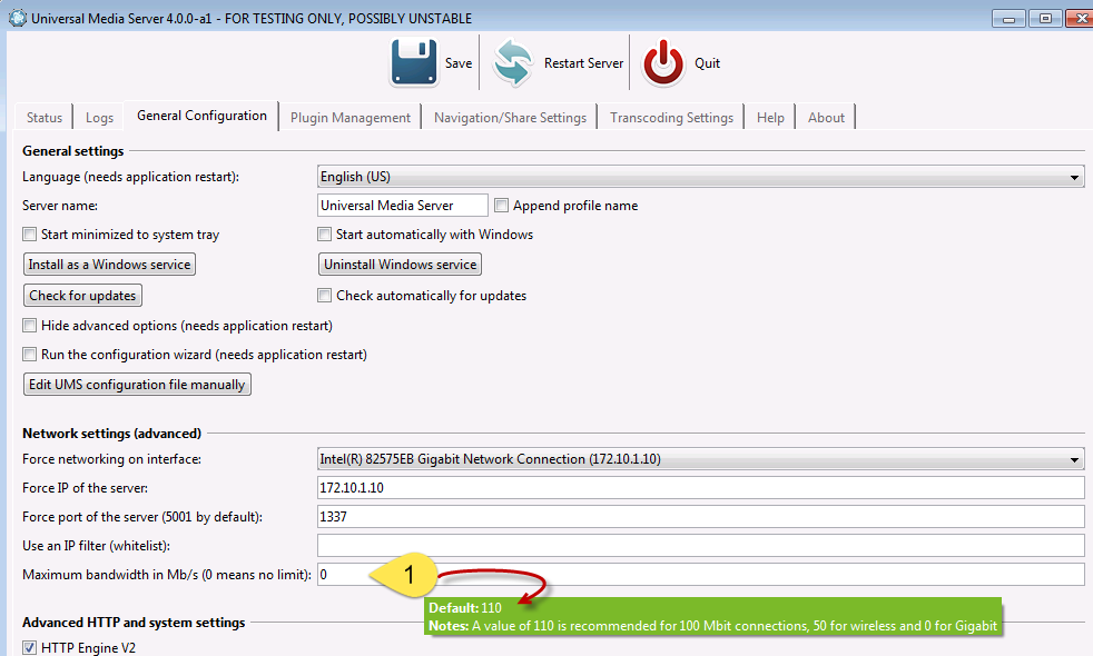

DeFlanko
Posts: 724
Location: San Pedro, CA
Contact:
Re: problems with ums and smart tv
Post by DeFlanko »
ays wrote:Hi DeFlanko I have already sent in the log files. I can do it again if you need them but is the procedure you describe any different to what I have done already?
Is there a simple way to check UMS to make sure it is set to wireless?
Possibly... have you edited these two spots?
