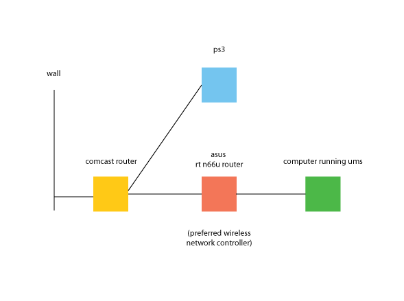

I'm having trouble connecting UMS to a ps3 with a wired connection (because otherwise there's skipping) over a network with 2 routers. For reference I've attached an image below to allow for a clear picture of my setup. When the ps3 connects to the network via the wired connection, it cannot see the UMS being run on the computer.
I found this thread, which recommended disabling the DCHP on what in my setup is the asus router, but it both did not solve the issue with UMS, but also disabled my 2 wireless networks being controlled by the asus router.
Is there any way to make UMS visible with this setup, and if possible still allow me to run my wireless network via the asus router? Thanks

Can't you plug the PS3 into the Asus?

You're PC and ps3 are most likely ending up on two different subnets.
Make sure that each device is on the same subnet,
so for example
Router 1: 192.168.0.1
Router 2: 192.168.0.2
PS3: 192.168.0.3
PC: 192.168.0.4
All with a subnet mask of 255.255.255.0 and a gateway of 192.168.0.1

thanks for the suggestion. the layout of the room more or less prevents that from happening.
jj123:
That's a good idea, i just have no idea how to do it. What I did try was deactivating the DNS on the comcast router, but that neither helped the UMS issue, but it also created other problems. Is there some resource you know of on how to do that?

I've had a network with 2 different routers. I had to do exactly what jj123 suggested. I also set up static IP address to all my main devices so that there would be no confusion of the main devices. I only had the gateway router do DHCP for the occasional mobile device. It's not hard to give static IP addresses to your devices.

which do you consider the gateway router. I tried putting my comcast router in bridge mode, but it didn't work by itself anyway. Again, I hope to be able to maintain the asus router as the primary hub, and the comcast router as a bridge/gateway

Yeah, different subnets is probably the problem. The DLNA broadcast won't normally propagate across them.
I have two subnets at home for various reasons and and trying to find the time to see if IGMP-Proxy can be used to pass the broadcast across the subnets. Once they see each other; everything should work (I've opened the relevant ports between the two).
Long Ethernet cables are only a few £ and might be the simplest answer (connect PS3 to router).
Static IPs (added on the router per-MAC address) can also reduce confusion when sorting things out.

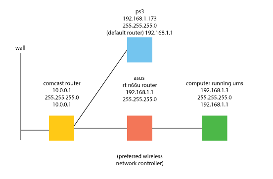

cnrhus , if you can update your diagram with the current IP details that each device currently has:
So for each device please provide the following:
IP address:
Subnet mask:
Gateway IP address:
Once I know that information I'll write you a little step by step guide on which of your devices need configuring in order to get things working.

jj123, thanks for taking the time. I've attached the image which features what I think are the correct numbers. I wasn't able to find the Gateway IP address on the asus router and the ps3.

I'm not 100% sure (but 90%) but DLNA(SSDP) uses multicast to detect devices. And normally multicast messages has a TTL of 1 or 2 to avoid them being spread over the networks. You should have the PS3 and the server plugged to the SAME router/switch.
