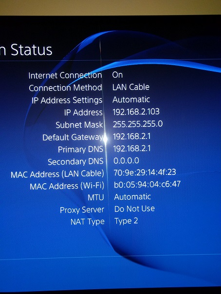

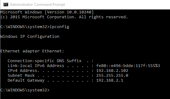

They are on the same subnet, see my ipconfig here on the PC and from the PS4 both attached. The PS3 is also on the same subnet.

The only thing I can find is that the IP of your server (192.168.2.101) mismatches with your screenshot (192.168.2.102), but I'm guessing that you have changed that since you took the screenshot. In the last log, UMS finds a device 192.168.2.103 which I assume is the PS4. It doesn't receive any further contact from 192.168.2.103 though. UMS also finds your router on 192.168.2.1.
I have no idea why this doesn't work, maybe restarting the PS4 while UMS is running could help? I take it the Windows firewall is still off. The only thing I can see that I find a little bit strange is that the PS4 lists NAT to NAT type 2. I'm not sure how to interpret that. Either it's read the router configuration via UPnP, and the router should run NAT, or NAT is somehow configured in the PS4 itself. NAT should NOT be configured in the PS4, that would block network traffic to the PS4. Maybe you should check the network configuration for the PS4 to make sure there is no NAT configured there. That doesn't explain why the PS3 isn't found though.
