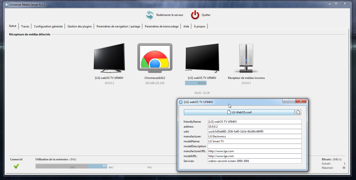

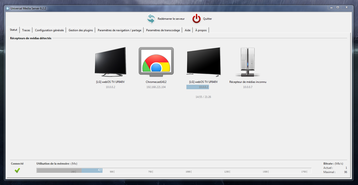

I had bought a LG 43UF64 smartTV.
I using UMS since a long time (~5 years). I haven't any problem for connect UMS and PS3/XBOX360/cellphone.
With my New television, I have "lag" with smartshare (~one seconde video> ~one seconde loading etc.). On the PC, all seems OK but i'm seeing 2 televisions detected and the 2 stop if I close TV. Only one seems active.
I think if it's possible that the second "TV" try to connect on the serveur and interrupt all second the first... The TV is connect by ethernet on the router and my PC too.
Anyone can help me?

- 2016-04-30 12_35_12-Program Manager OK.png (258.57 KiB) Viewed 8913 times
- 2016_04_30_12_33_47_Program_Manager.png (223.51 KiB) Viewed 8913 times

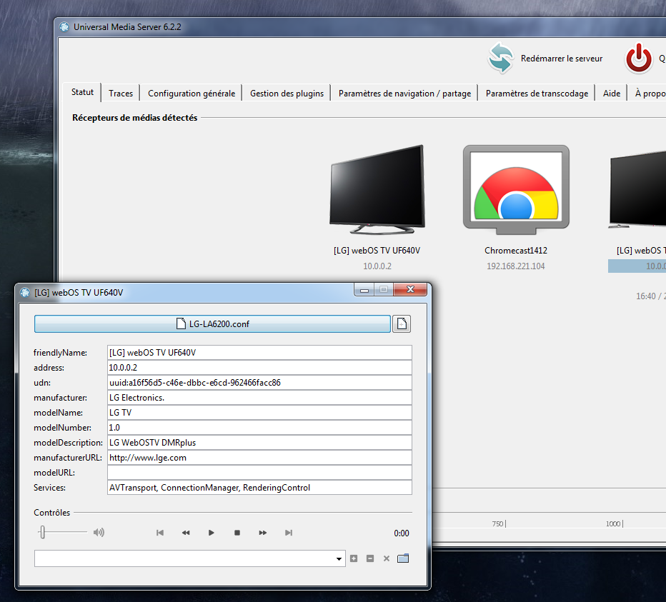

And the not ok TV
- 2016-04-30 12_35_32-Program Manager NOT OK.png (249.7 KiB) Viewed 8912 times

I've just bought a new LG TV ( OLED 55B6V with WebOS 3.0 ) and I've the same issue. I see two renderer found by UMS.
Disabling all LG profiles just make them appear as "uknow renderer".
