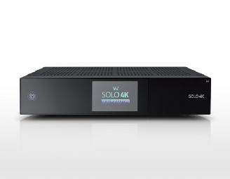

Hello my friends,
I'm an absolute beginner and I'd like to use the VU+ Solo 4K as a DLNA client.
I tried to build a renderer.conf but that's too complicated for me.
Also at the risk of making me ridiculous here, I send my not finished file and the logs as attachments.
Maybe there is somebody who can show me the way through the jungle.
The only specs I was able to find on the German web site (on the US web site I couldn't find any): http://vuplus.de/produkt_solo4k.php - "Videodekodierung:"
Videokompression HVEC / H.265, MPEG-2 / H.264 und MPEG-1 kompatibel
Videostandard PAL G/ 25 Hz, NTSC
Bildformat 4:3 / 16:9
Letterbox für 4:3 TV-Geräte
Thank you very much indeed for your efforts.

Unfortunately, the custom version isn't working very well.
1. The VU+ Solo 4 K (192.168.0.21) is not recognized by the UMS
2. Contents of the shared folders are not visible except *.mp3-files
The log file is too big, but I copied a section out of it as an attachment.
There is one line which seems conspicuous to us:
DEBUG 2016-11-23 15:02:37.128 [mplayer.exe-0] net.pms.io.ProcessWrapperImpl.run Starting C:\work\UniversalMediaServer/bin/win32/mplayer.exe dummy
I found an old post from January 2010 about the VU+ specs and added it as an attachment.
Thank you very much for taking some time.
