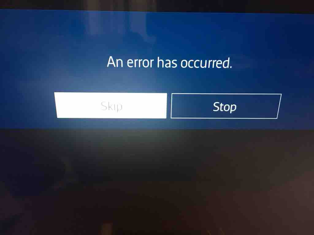

Unsetting Prettify filenames makes no difference.
When I say unable to playback, I mean I am getting an error on the TV.
I should point out that the majority of mkv files work without any issues although a subset are giving me this error.
Re: Playback on Samsung JS7200
I'll look more deeply at your log later.
That weird though...
For now you can try to set your maximum bandwith to 60Mb/s.

I've limited the maximum bandwidth and set the DefaultVBVBufSize to no avail. The error still occurs.

I've not had an issue with other older files. I seem to have issues with the newer files (circa past 3 months or so), and especially with 4K files.
Create the video manually with this command, and play it from a USB/HDD plugged in your TV.
Is that work ?
If it doesn't, try that:
After having tested that these videos work, or not, from your USB's TV, try to play the working one with UMS, and report your results here.
/home/ums-user/ums-6.6.0/linux/ffmpeg64 -i "/data/ums-user/Media/English/Doctor Strange (2016).mkv" -map 0:v -map 0:a:0 -bufsize 1000000k -maxrate 999000k -crf 19 -ac 6 -ab 640k -ar 48000 -c:a ac3 -c:v libx264 -tune zerolatency -preset ultrafast -level 31 -pix_fmt yuv420p -f mpegts DrStrange_1.ts
ffmpeg64 -i "/data/ums-user/Media/English/Doctor Strange (2016).mkv" -map 0:v -map 0:a:0 -bufsize 31000k -maxrate 30000k -crf 19 -ac 2 -ab 448k -ar 48000 -c:a ac3 -c:v libx264 -tune zerolatency -preset ultrafast -level 41 -pix_fmt yuv420p -f mpegts DrStrange_2.ts

Yea fortunately the TV can play a lot of formats directly (no encoding). It basically supports all common file types/codecs so it's very likely that you have never needed transcoding until now.busyguy wrote:Hi,squadjot wrote:Afaik transcoding never worked on the j model
If you have #--transcode--# folders enabled, can you play the file called [No encoding]?

Actually, you are using an inappropriate renderer configuration file.
Did you already tried forcing the Samsung J6200 renderer from UMS ?
If you feel happy with your, just use this slighty modified one:(that's said all your videos bitrate are wrong and all the images size specifications are unecessary as the next UMS version will automatically take care of that, because they outpass the DLNA specifications)
1) 2) 3) 4)
And take time to report back
After that we should know better what work best for your renderer.
