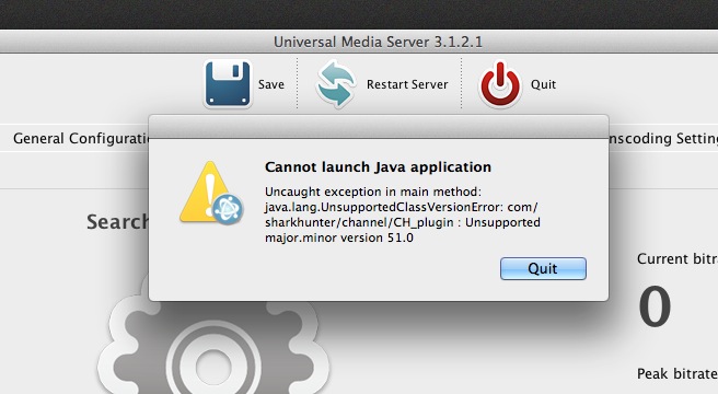

Re: [fixed] Problem with file length display on ps3 since 3.
yes
my version is the last one. with the one before it freezes the movies and doesn´t work very well with the maverick software.
i try now to follow your instructions, but when i put the program that happened to me:
- Captura de pantalla 2013-11-28 a la(s) 02.26.37.jpg (58.2 KiB) Viewed 8934 times
Try clearing the plugins folder
