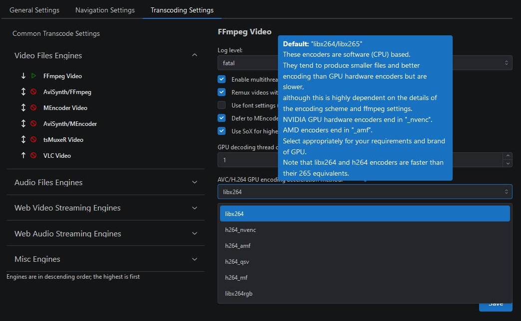

I'm using UMS on arch. Not sure why, but it seems like ffmpeg is totally busted on my setup. Not sure what to try.
I was trying to set up hardware acceleration. I compiled ffmpeg from source with git clone, make & then sudo make install - now everything's busted. I tried sudo make uninstall, no luck.
