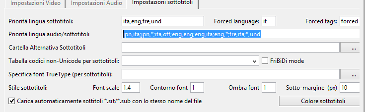

I want to setup UMS this way:
if the language is japanese, use italian subtitles; if italian isn't available, anything else will do
if the audio is in english, try with english subtitles first, then ita, then everything else
if the audio is french, try with italian subs
I'm using the settings in the picture: will they work as expected or the syntax is wrong? Where can I find how to set them properly?
Thanks in advance

Yes, your construction is correct.
Some very old FAQ how it works(ed)...
http://code.google.com/p/pms-exsport/wiki/FAQ

Thanks a lot!ExSport wrote:Yes, your construction is correct.
