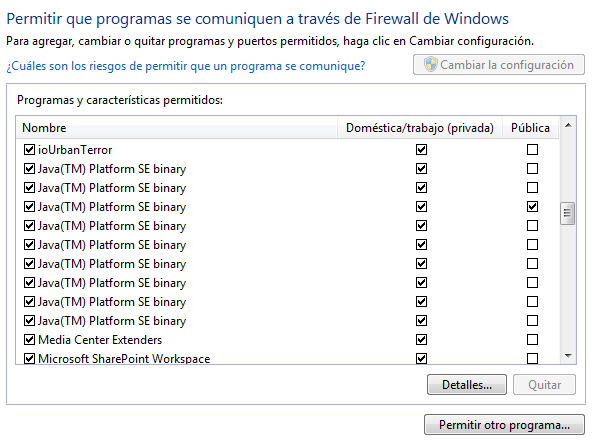

Ok, sorry i was going to post the bad try log, but, installed version for Java 8 instead of 7, then it doesnt work, but i try again to switch off windows firewall for local intranet and voilá...
Start digging in the exceptions of the firewall, and i think i had to add all the "Java ... Platform ... instances" (attached image) in addition to the UMS.exe.
Anyway with la java instances and ums.exe in the exceptions of firewal for intranet, now it works ok.
Thanks and sorry.
Thanks and sorry.
