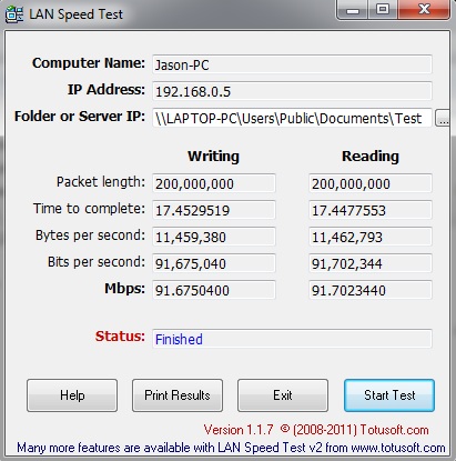

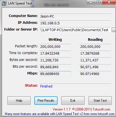

I did a lan speed test with a laptop at the point the ps3 plugs into. I wasnt sure which points to post so i did a screengrab (and crop lol) of with a hub in line and with out. used a 200meg test file
Does one of you guys who knows your nuggets see anything that would suggest a problem that may be causing the stuttering?
- LanSpeedTest-NoHub.jpg (63.58 KiB) Viewed 13152 times
- LanSpeedTest-Hub.jpg (63.36 KiB) Viewed 13152 times

Just curious.. if you start the movie, and then pause it for 30 seconds..and then unpause, does it then play fluently for a while?
Re: Bad Stuttering
Maybe try setting the maximum bandwidth limit on the General Configuration page to 80 or 90?
Also you can try setting the MPEG-2 options on the Transcoding Settings page to keyint=25:vqscale=1:vqmin=2 which will produce the same quality with a lower bitrate
Re: Bad Stuttering
Ok.. pausing for approx 3-4 minutes (while i made some toast) produced smooth playback of approx 2-3 seconds
Mr Subjunk, your reply suggests to me you think it might be bandwidth or am i misunderstanding you?
Cheers for the feedback guys
Re: Bad Stuttering
Yeah bandwidth would be my guess, you measured it at 90mbps and by default UMS limits videos to 110mbps so try changing that limit
